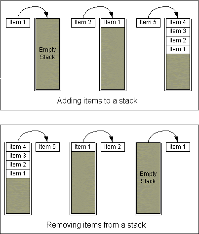

The following figure illustrates adding and removing items from a stack. You can see why a stack structure is often referred to as LIFO—Last In, First Out:
