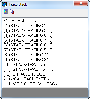

As an example, load the following code in Visual LISP, set a breakpoint as indicated in the code comments, and then start the TRACE-10-DEEP command.

The Trace Stack window from the previous sample code looks like the following illustration when program execution is interrupted at the set breakpoint.
