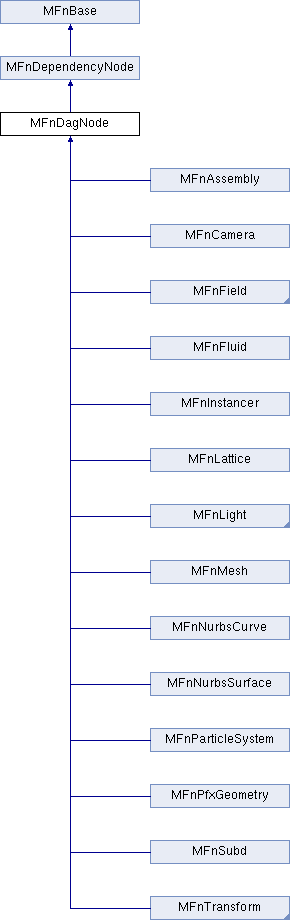

C++ API Reference
DAG Node Function Set. More...
#include <MFnDagNode.h>
Provides methods for attaching Function Sets to, querying, and adding children to DAG Nodes. Particularly useful when used in conjunction with the DAG Iterator class (MItDag).
The MFnDagNode function set is used to query and set the attributes of nodes in the DAG (Directed Acyclic Graph). The DAG is a graph that describes the hierarchy of the objects in the model. At each level of the hierarchy there is a four by four transformation matrix that affects all of the objects beneath it in the DAG.
In the DAG, geometry objects (also known as shapes) do not have transformation information associated with them. Only transform nodes have actual transform matrices (see MFnTransform).
Each node that exists in the DAG is also a dependency node that exists in the dependency graph. This makes it possible to control the attributes of a DAG node based on calculations performed by dependency nodes.
There are two ways to specify a DAG node in Maya. The first is to use an MObject handle, which acts as a pointer to a specific node in the DAG. Given only an MObject, it is not possible to do world space operations on a DAG node because there may be more than one path through the DAG to any given node. In other words, it is not possible to identify a particular instance only given an MObject.
In many cases it is preferable to use a DAG path (MDagPath) to specify a DAG node. A DAG path always refers to a specific instance of an object. This makes it possible to perform unambiguous world space transformations.
It is also possible to iterate over the nodes in the DAG using a DAG iterator (MItDag).
