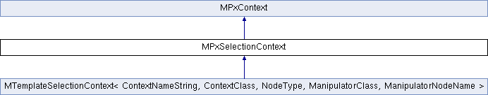

Base class for interative selection tools. More...
#include <MPxSelectionContext.h>
This class is used in creating user defined tools that use the internal selection mechanism in maya.
OPENMAYA_MAJOR_NAMESPACE_OPEN MPxSelectionContext | ( | ) |
