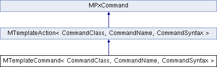

C++ API Reference
Template class for undoable commands. More...
#include <MTemplateCommand.h>
Public Member Functions | |
bool | isUndoable () const override |
