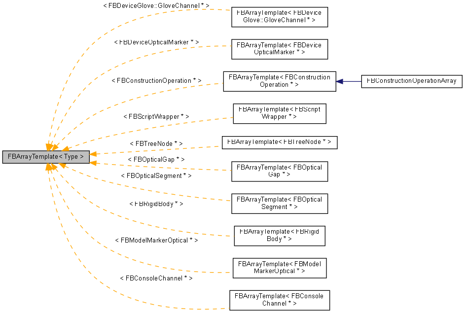

Template class to contain an array of items. More...
