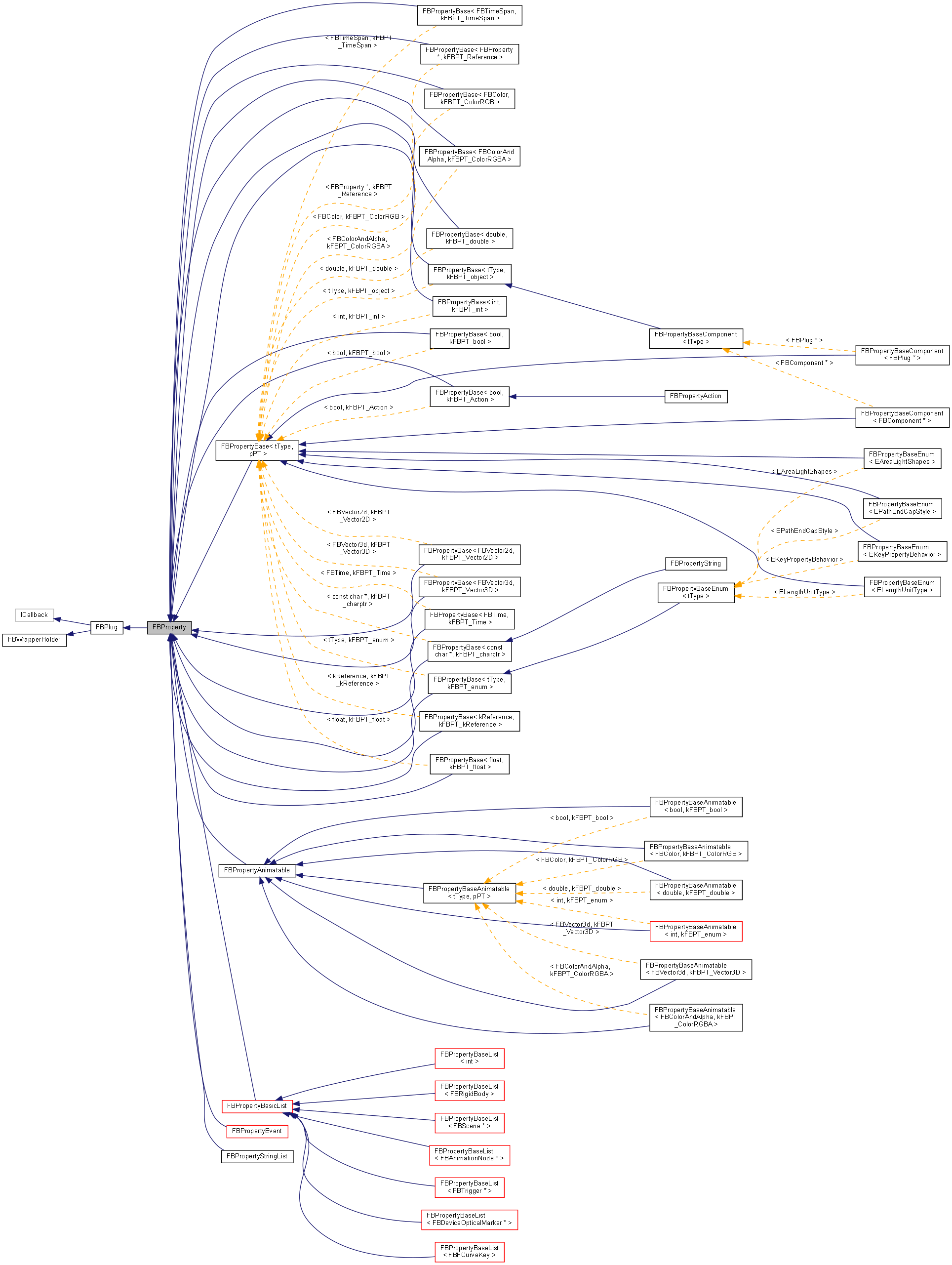

Property: Base property class.
A property is a holder for function callbacks into the internals of the application.
You cannot instantiate FBProperty objects. To reference a property:
- Use an instance of an FBComponent object. The methods FBComponent::PropertyCreate and FBComponent::PropertyRemove can be used to modify an object's set of properties. When accessing a FBProperty object via its containing object, you can get or set (assuming it is not read-only) its value directly, for example in Python: myObject.Visibility = True.
- FBPropertyManager exists in all FBComponent objects, and contains an array of all the registered properties. Use FBProperty::Find to find a property by name. When accessing a property reference directly, its value is obtained via its 'Data' member.
myProp = myObject.PropertyList.Find( 'Visibility' )
if myProp: myProp.Data = True
To see how to create a custom property in Python, see CustomProperty.py.
Definition at line 194 of file fbproperties.h.
