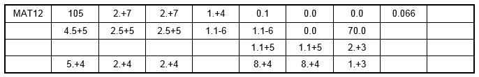

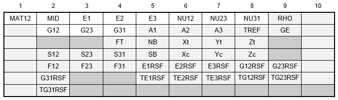

Description: Defines the material property for an orthotropic material for isoparametric solid elements.
Format:
Example:
Field | Definition | Type | Default | ||||||||||||
