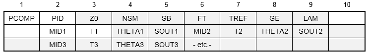

Description: Defines the properties of an n-ply composite material laminate.
Format:
Example:
