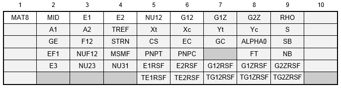

Description: Defines the material property for an orthotropic material for isoparametric shell elements.
Format:
Example:
