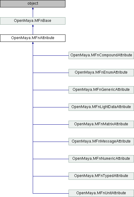

Base class for attribute functionsets. Method resolution order: - MFnAttribute - MFnBase - builtins.object
MFnBase<h2>Constructors
