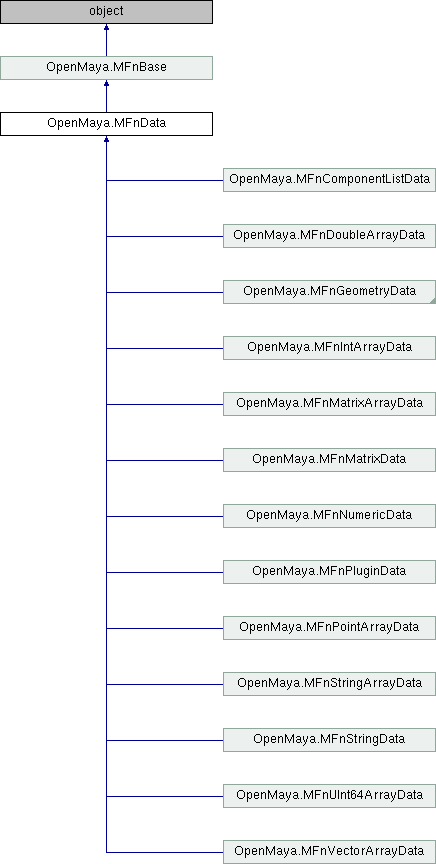

Base class for dependency graph data function sets. Method resolution order: - MFnData - MFnBase - builtins.object
Base class for data function sets.
MFnBase<h2>Constructors
Signature | Parameters | Description |
MFnData() | Default constructor. Returns a new MFnData function set with no Maya object attached. | |
MFnData(object) | object - MObject | Returns a new MFnData function set, attached to the specified Maya object. |
