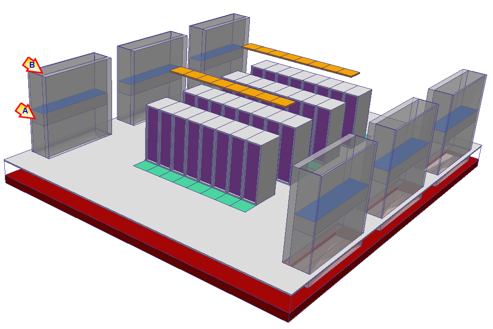

A heat exchanger device (A) simulates the effect of a CRAC (B) unit in a data center. The objective is to remove a specific amount of heat.
We've modeled the heat exchanger device as a rectangular block within the CRAC. Also, the CRAC unit part is suppressed (not meshed). For more about modeling CRAC units, click here.

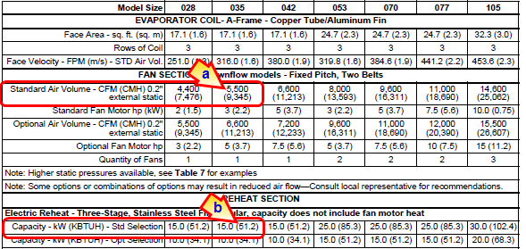

System settings:
The flow rate and heat input/extraction rate were taken from manufacturer-supplied data:
