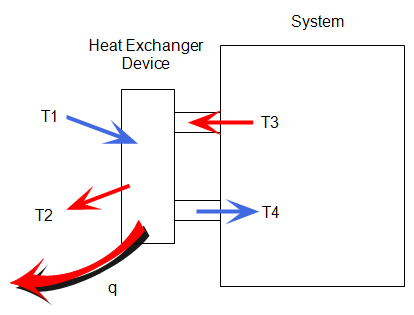

Define the thermal behavior of the heat exchanger device. The following heat exchanger device schematic illustrates the conventions used in the variation methods descriptions:

The Heat Exchanger mode removes heat from the working fluid. Conceptually it is similar to a physical heat exchanger device.
Specify the following:
As hot air from the system enters the heat exchanger at temperature T3, heat, q, is extracted at the specified heat capacity rate. Cooled air re-enters the system at temperature T4.
