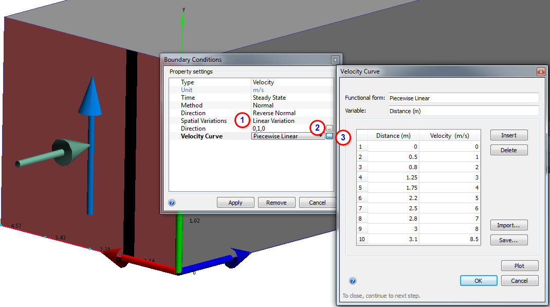

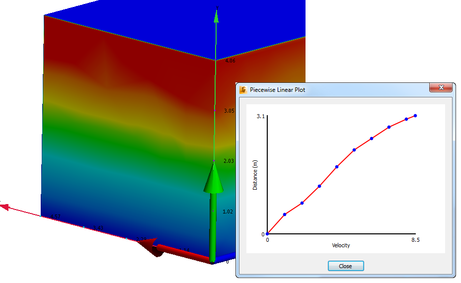

The Linear Variation provides a way to vary a velocity or temperature boundary condition in one dimension across a boundary surface.
The wind flow around architectural structures (buildings) often has a parabolic distribution increasing from ground level through the height of the buildings. Accounting for this velocity profile is essential for accurately accounting for wind shear effects. You can use the Linear Variation flow profile to specify velocity at specific locations using a piece-wise linear distribution.
