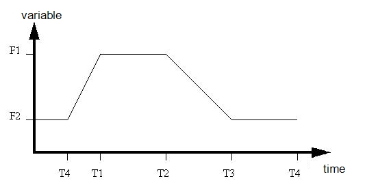

The Ramp-Step function combines a linear ramp function with a flat step function:
The T values are the times that inflections occur.
The F values are the min and max of the variables.
