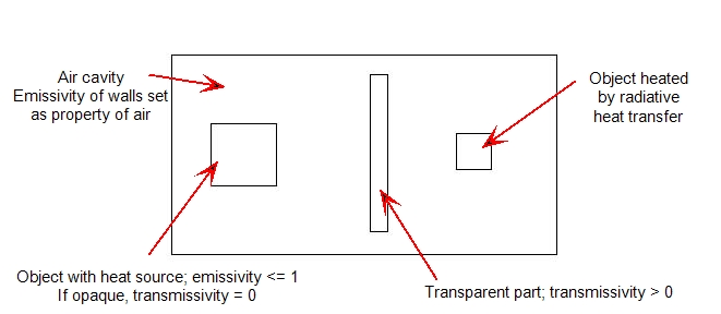

The radiation model supports radiative heat transfer through transparent solid media. The transmissivity material property defines the level of transparency of a solid object. Radiative heat transfer through a transparent solid object that is completely surrounded by fluid can be simulated by assigning a non-zero transmissivity property to the material. Opaque solids that are enclosed by transparent solids can be modeled as well. This even allows “nesting” of multiple layers of opaque and transparent solids.
In the radiation model, radiative energy that passes through a transparent solid does not experience an attenuation effect--there is no absorption of radiative energy into the media. There is no accounting for spectral effects within a transparent object, and energy leaves the object in a diffuse manner. Energy may, however, be absorbed through the surface and then emitted (emissivity = absorptivity). The energy balance for radiative heat transfer looks like:
where the reflectivity = 1 - emissivity - transmissivity
For more about creating custom materials...
To include radiative heat transfer through a transparent solid that is completely surrounded by a fluid, assign a non-zero value of transmissivity to a custom material. For more about creating custom materials...
Note that the sum of transmissivity and emissivity must be less than or equal to 1.

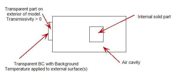

To include radiative heat transfer through a transparent surface on the external wall, such as a window:
The temperature specified with this boundary condition is used to define the incoming radiation flux according to this equation:
Transparent BCs should only be applied to external boundaries so that the incoming flux is external to the analysis domain. They must be assigned to a solid material; assignment to a fluid material will result in an error.

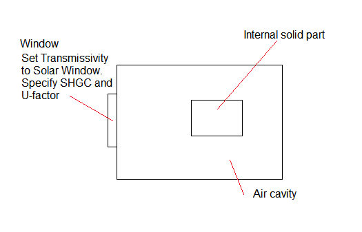

To include Solar Heating through an external transparent surface, such as a window:
