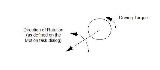

A driving torque is positive when applied in the reference direction of motion (as specified on the Motion task dialog). A negative driving torque will act in the opposite direction.
Examples of driving torque include electromagnetic and other body torque as well as torque imposed by objects omitted from the analysis geometry. The torque will act in the same direction as the direction of motion (as specified on the Motion task dialog).

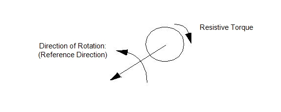

Applied resistive torque affects the rotation of the object by acting against its specified rotational direction, impeding its progress. A positive value of a resistive torque acts in the opposite direction of rotation; a negative value acts in the direction of rotation.

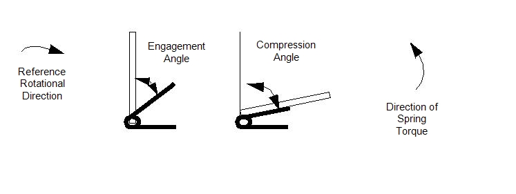

The following diagrams describe setting up several scenarios involving torsional springs.
Note that all specified displacements act relative to the initial position specified with the Initial Position slider on the Motion task dialog.
If the object is not touching the spring at time = 0, then the configuration may appear as:

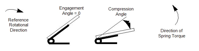

If the object is touching the spring at time=0, then the engagement angle is 0:

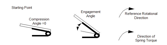

If at time = 0 the spring is fully compressed by the object, then the compression angle is zero, and the engagement angle is the angle to where the spring is no longer compressed:

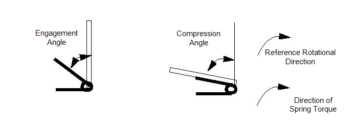

If the flow is such that the object rotates in an angle opposite of its reference angle to contact the spring, then the engagement and compression angles should be applied as negative values:
