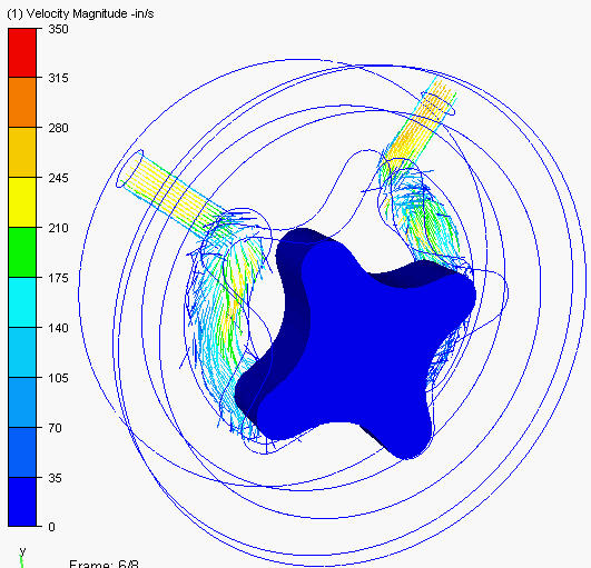

Unlike the Rotating Region material device, objects with an angular motion can have paths that interfere--such as gear teeth in a gear pump or multiple mixing blades in an egg-beater.

Assign Angular Motion to devices that move fluid (liquid or gas) using a volume displacement or that simply move through fluid. Conversely, surround a rotating device with a rotating region that moves fluid through an energy transfer. Such devices rely on the Coriolis effect and centripetal acceleration.
Rotating regions will produce a more accurate answer, and typically require less computational resources. Moving solids (specified angular motion) are more versatile, and can solve a wider variety of applications.
