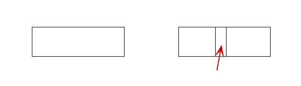

In the following example, the original part is on the left. On the right, an additional part splits the original. The two surfaces on either side of the additional part are considered to be the same surface. Settings applied to one side may jump to the other or simply be lost.
An easy fix is to add a protrusion or cut feature to one of the volumes so that the surfaces are unique. This prevents conditions from jumping or being lost.
