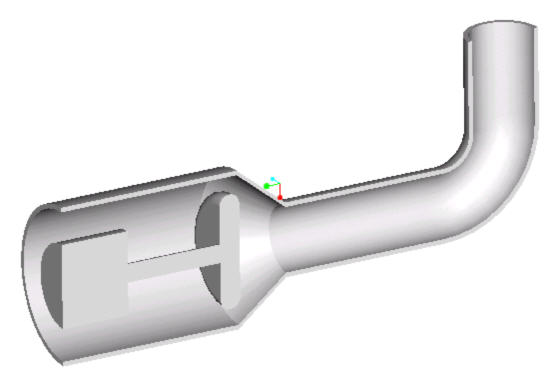

For internal flows, a flow core must be created from the existing surrounding geometry. The outer walls of the volume are omitted (unless they are to be used as part of a heat transfer calculation) and the interior volume of the pipe is modeled.
In contrast, in a structural analysis the walls of the pipe would be meshed and the interior would be omitted from the calculation domain:

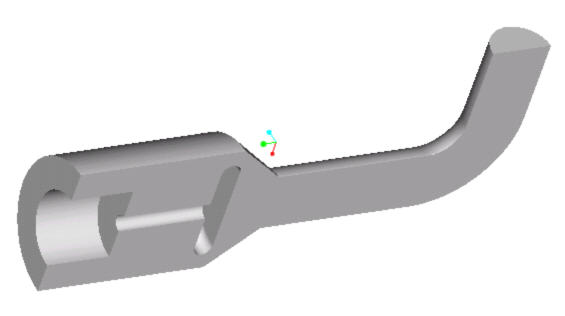

A pipe is filled with water and the water is allowed to freeze. Now, imagine that the pipe walls are removed, and all that remained was the solid volume of ice. This volume is where the fluid exists, and is the geometry that would be created and meshed for a CFD analysis of flow through that pipe.
The flow volume can be created directly in the CAD tool (Pro/Engineer, Inventor, CoCreate, Solid Edge, SpaceClaim, UGNX, SolidWorks) or with the Autodesk® CFD Void Fill Geometry Tool. An additional technique is to create a volume in the CAD model that covers each opening. Autodesk® CFD automatically creates parts to fill fully-bounded, air-tight voids.
Example showing an internal flow volume
