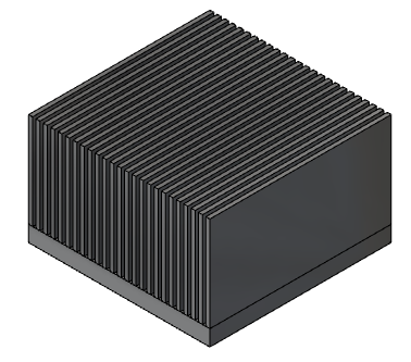

You have a large electronics system to model, but the system contains heat sinks with high fin counts and high fin aspect ratios. You soon realize that including the actual heat sink geometries in your model requires millions of elements for accurate simulation. Fortunately, you have another alternative - the use of heat sink materials. With heat sink materials, you simulate both the fluid and heat flow characteristics of your heat sinks without the need for computationally intensive meshes.

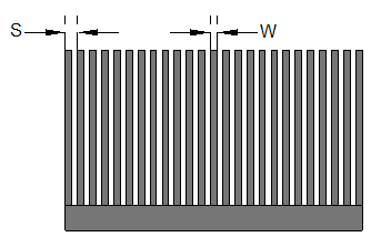

Micro Channel
Specify the following:
Periodic Spacing (S) between fins.
Width (W) of the fins.
Number of fins.

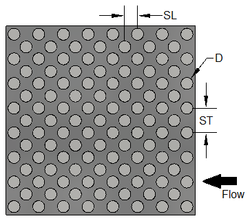

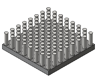

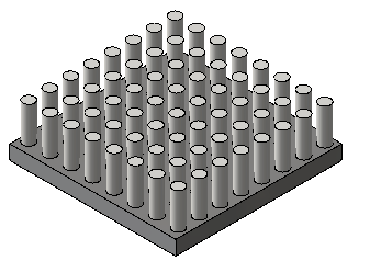

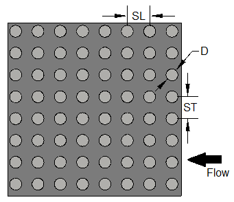

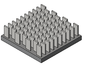

Pin-Fin in Line or Pin-Fin Staggered
Flow direction spacing (SL).
Number of pins (in a row) in the flow direction.
Normal direction spacing (ST).
Number of pins (in a row) in the direction normal to the flow.
Diameter (D).

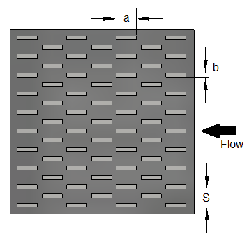

Offset Strip
Flow direction length (a).
Number of fins (in a row) in the flow direction.
Normal direction width (b).
Normal direction spacing (S).
Number of fins (in a row) in the direction normal to the flow.
