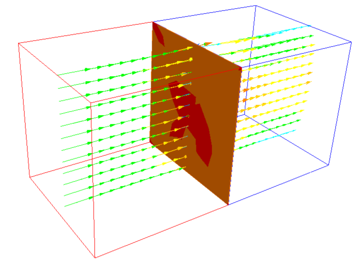

Geometric Guidelines
Distributed resistance surface parts are very flexible, and can contact the surrounding wall on one or more edges and even be completely submerged within the fluid:

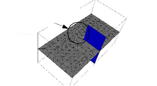

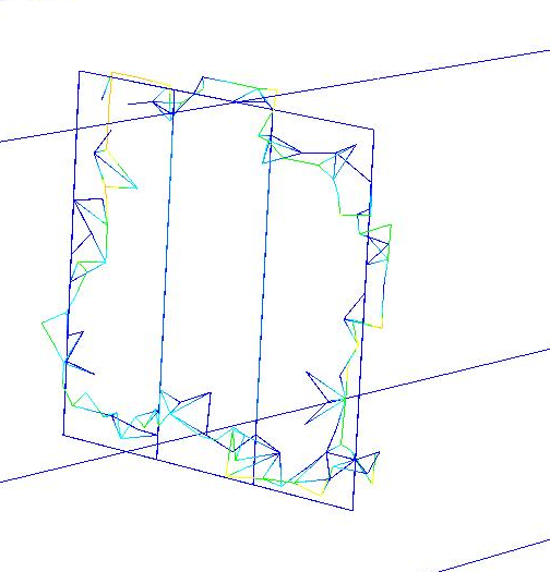

It is very important that the fluid mesh between the edge of a floating resistance surface and the neighboring wall have at least a single row of nodes between them. If no nodes exist in this region, an error will be issued:
In the following case, the region between the edge of the surface part resistance (in blue) and the wall must have more than one row of nodes.

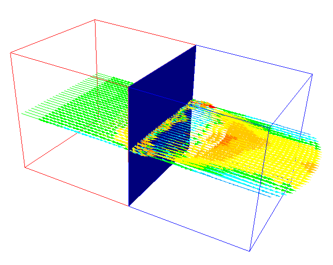

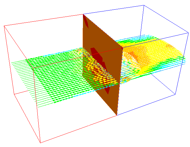

Distributed resistance surface parts can be planar or arbitrarily shaped. The flow direction will always be locally normal to the surface part. Note that there are limitations to the shape of a surface part. Very high curvature surfaces are not suitable for use as distributed resistances, and an error may be given.

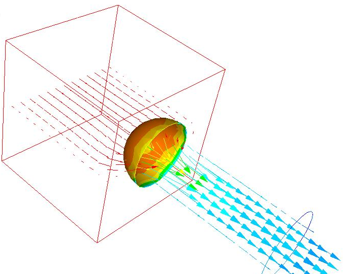

Some recommended shapes for resistance surface parts include planes and hemispheres:

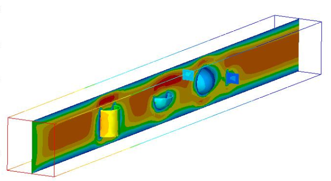

Examples of a baffles modeled with surface parts
