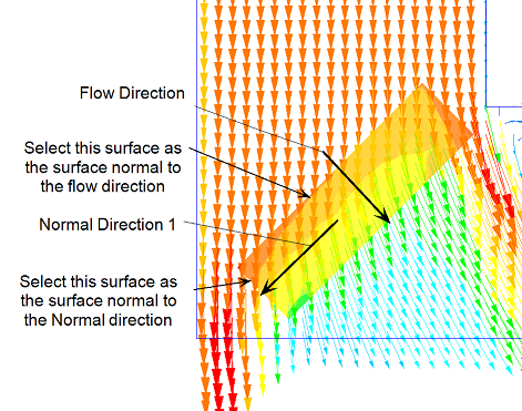

To align the flow with a selected surface, open the pop-out dialog, and click the Select Surface button.
Resistance values for the normal directions specified on the Resistance Material Editor will be used by the Solver. The following image shows flow passing through a resistance object that is inclined at an angle to the flow. In this example, the Flow and Normal Direction 1 resistances were set to the same value. Obviously, the values can be different if desired:

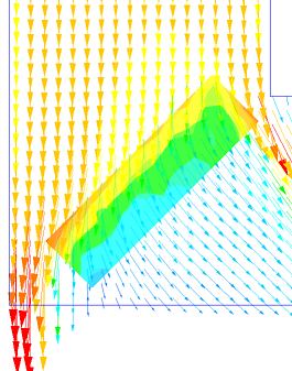

The flow is turned slightly, but is not completely realigned to be normal to the resistance object.
To force the flow to be normal to a resistance (to produce a “vent” resistance), set the Normal Direction resistances to be at least three orders of magnitude greater than the Through Flow K. This causes the flow to turn so that its direction is normal to the resistance object.

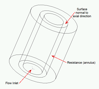

Another application for the Radial flow direction resistance is for a bank of resistive cylinders over which the flow must pass. In this case, the flow direction is again Radial, and an axial direction (select a surface normal to the axis of the cylinder) must be selected:
