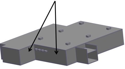

Apply surface boundary conditions only on exterior surfaces or to surfaces that are adjacent to suppressed parts (Such parts contact a meshed volume on one side and nothing on the other).
For example, if the walls, roof, and windows of a building are meshed, assign surface thermal boundaries around the exterior surfaces:

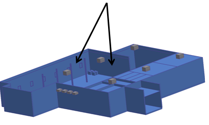

If, however, the walls, roof, and windows are suppressed (not meshed), assign surface thermal boundary conditions to the surfaces of the suppressed walls where they contact the internal air volume:
