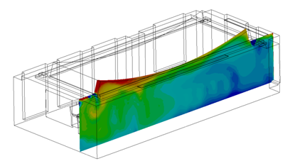

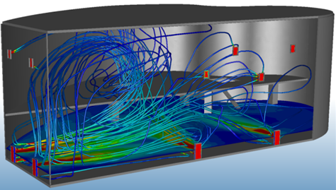

Mechanical Ventilation
Mechanical Ventilation analyses simulate the air flow in spaces that are controlled with air management systems. Such systems typically include a network of diffusers, fans, and returns designed to ensure proper air flow and temperature control within the occupied area.
