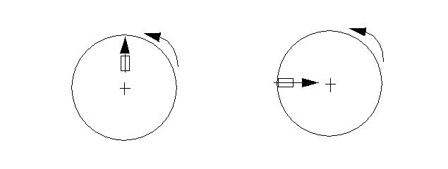

Vanes or pistons rotate about the center-line of the impeller, but translate radially. The direction of linear travel changes at every angular position. The axis of rotation, however, remains constant.
This diagram shows how the direction of translation changes based on angular position:
