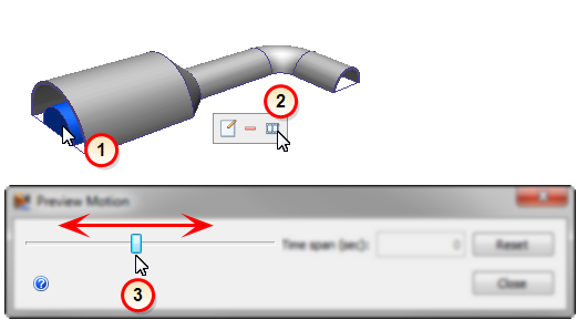

After assigning a motion to a solid part, it is always a good idea to preview the motion to ensure the expected result. To open the Preview Motion dialog, either click Preview from the Motion context panel, or click the Preview icon from the Motion context toolbar (shown below).
To preview the motion, drag the slider on the Preview Motion dialog.
The time span is computed based on the motion definition. A pseudo-time span is used for flow-driven motion.
