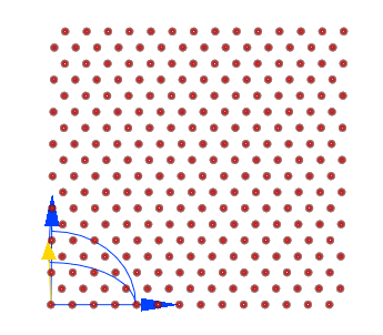

The Diamond pattern staggers the seed points through the plane:
The Grid pattern creates an ordered distribution:
The Hexagon pattern staggers the seed points into a hexagonal distribution:
