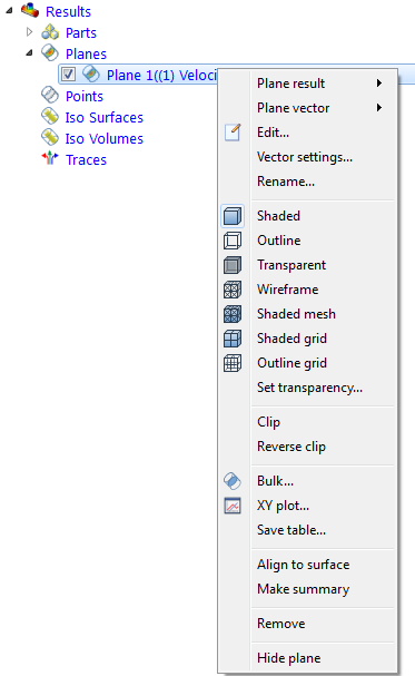

Planes are the primary way to visualize results on three dimensional models.
To interact with Planes, click Results (tab) > Results Tasks (panel) > Planes.

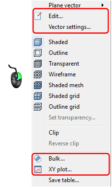

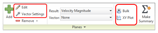

Planes provide a wide array of visualization functionality:
a. Settings (Controls) b. Vector settings c. Bulk d. XY Plot | ![]() |
On-model Method 2: Right click on the Plane, and select from the menu.
Off-model: Click the icon in the Planes context panel.
Off-model Method 2: Right click on the Plane from the Planes branch of the Design Study bar.
