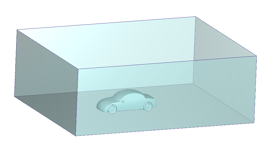

An example is a volume constructed in the wake of an aerodynamics study. The volume is simple, so its automatically-defined mesh will be coarse. Because the flow is quite energetic and will have high gradients, a finer mesh is required in the wake region:

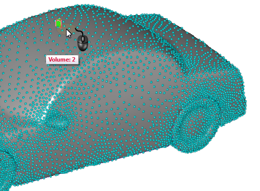

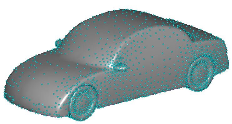

After clicking Autosize to define the mesh distribution on the model, cyan dots appear across the model. These represent an approximate mesh density. They do not indicate actual node locations. You can use these to determine where the mesh will be finer and where it will be coarser. In the following example, the mesh will be finer near the wheels. Along the doors, the mesh will be coarser.

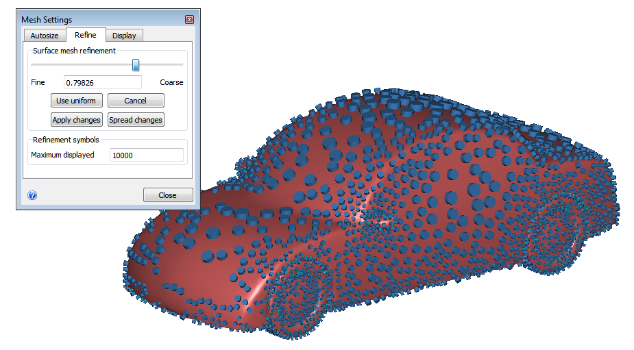

The slider uses a parametric scale, with a default position of 1.0. This provides a range for decreasing or increasing the mesh size from the original size. To apply a value that exceeds the minimum or maximum slider range, type the scaling value into the field below the slider.
As the slider is moved, the modified distribution updates dynamically. The distribution is indicated by either cylinders or prisms on the displayed on the model. These symbols appear as long as you are left clicked on the slider. When you release the mouse button, the symbols disappear. These symbols represent the size of the elements at specific locations. The width of the symbol shows the element size in the longitudinal direction and the height shows the wall layer thickness into the flow:
To undo the setting and reset the slider to the "1" position, click Cancel. To apply the setting based on the new slider position, click Apply changes.

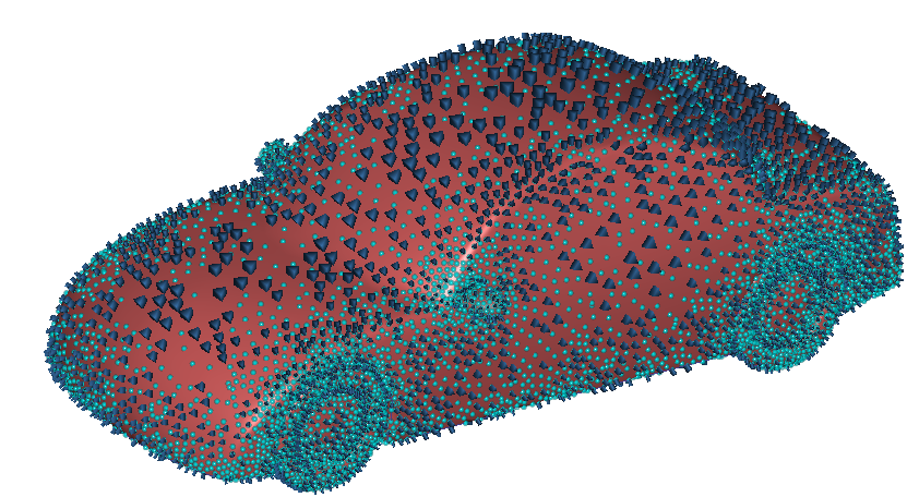

To preview the element appearance after clicking Apply changes, hover the mouse over the desired location on the model, and hold the Shift key. A prism symbol indicates the approximate element width and height at the current location:

As described in section above about modifying the mesh distribution with the slider, symbols appear on the model to indicate the width and height of the elements on the selected objects. By default, only 1000 of these symbols are drawn on the model. If your model is large or complex, increase the number of displayed symbols by changing the value in the Maximum displayed field. Be aware, however, that if you specify too high a value, the visual update/response time of your computer may slow appreciably.
By default, the refinement symbols appear as cylinders. To change them to prisms, click the Display tab, and select Prisms from the Show on model menu.
