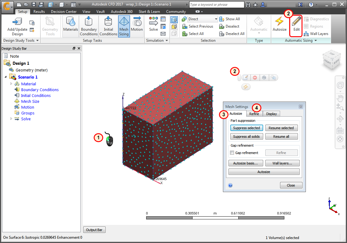

To access the meshing tools, click Setup (tab) > Setup Tasks (panel) > Mesh Sizing:
You can use these tools to help you define, modify, and preview the mesh.
There are multiple ways to apply Automatic Sizing:
In the Automatic Sizing context panel, click Autosize.
Left click on or near the model, and click the Automatic icon on the context toolbar:
Right click in the Graphics window or on the Mesh Size branch of the Design Study bar, and click Edit.... Click Autosize on the Mesh Settings quick edit dialog.
Use the controls on the Autosize tab of the Mesh Settings dialog to control part suppression and to customize the mesh distribution. You can access several of these tools from the left click context tool bar and from the Automatic Sizing context panel.
To modify the mesh distribution on the model:
Select the part.
Open the Mesh Settings quick edit dialog.
Make the appropriate changes to the Autosize basis parameters.
Refine the distribution on selected parts.
