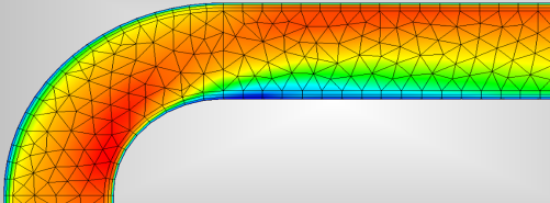

In the following image, the mesh is not adapted for the free shear layer, and the flow in this region is not sharply defined:

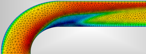

In this image, the mesh is adapted for free shear layers. Notice the sharp distinction of the velocity gradient between the free-stream and the separation region:

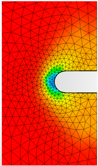

To focus the mesh on the location and gradients across shock waves in compressible flow, enable the Shocks option. In the following image, we can see the shock formation upstream of the object, but because the Shocks option was disabled, the mesh was not adapted to the shock, and the gradients are diffuse:

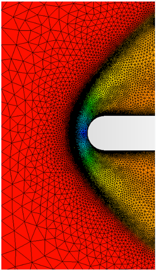

When Shocks is enabled, the mesh adapts based on the formation of the shock, and its location is clearly defined:
