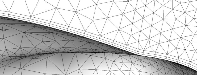

Wall Layers adds element layers along all fluid-wall and fluid-solid interfaces. It augments the original mesh to produce a smooth distribution along all walls, which is critical for accurate flow and temperature prediction. Wall Layers ensures adequate mesh across small gaps, which can be very difficult manually.
Wall Layers creates layers before the 3D mesh is constructed. Diagnostic algorithms detect and avoid element clashes in small gaps automatically. Element layer height across each surface is uniform, and is based on the smallest length scale on a surface. A gradual transition between surfaces ensures gradual variations in element height throughout the model.
Layer uniformity is important for accuracy in certain analyses. Examples include flows in which the turbulence is very sensitive to the flow near the walls and within long, narrow channels. In the latter case, meshes that have been enhanced have been shown to be significantly less disruptive than non-enhanced meshes to the flow near the walls, resulting in improved flow uniformity throughout the channel.

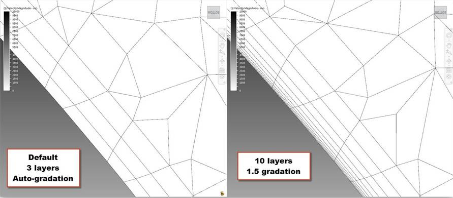

Use Layer gradation to control the rate of growth of the wall layers. As the number of wall layers increases, the layer thickness often has a tendency to become uniform. Gradation allows the layers nearest the wall to be smaller than those closest to the neighboring unstructured elements.
Use this setting to improve the accuracy of heat flux at the wall as well as for the SST k-omega turbulence model.
When the Number of layers is greater than 5, you should change the Layer gradation value from Auto to a value. This is an effective way to reduce the element thickness near the wall and the value of Turbulence y+. When simulating external aerodynamics with the SST k-omega turbulence model, a low value of y+ is essential for accurate flow prediction.
