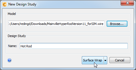

Import your model into Surface Wrap when you create a new design study:

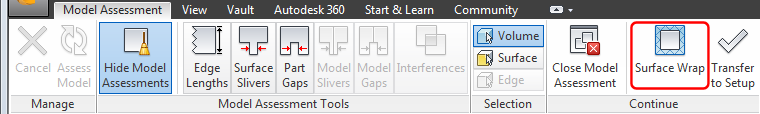

You can also access Surface Wrap from within the Model Assessment Toolkit:

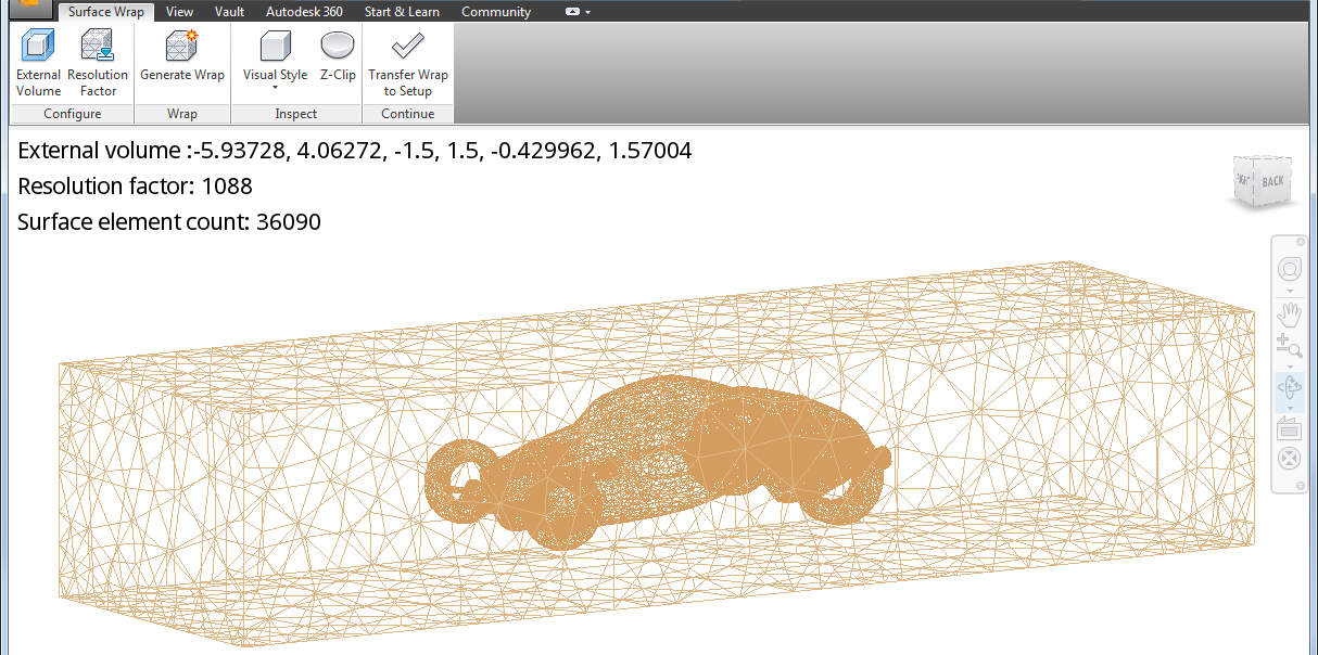

Set up your model in the wind tunnel.
Use Surface Wrap > Configure > Resolution Factor to set the appropriate level of detail for your surface mesh. Notable highlights:
Click Surface Wrap > Wrap > Generate Wrap to create your surface mesh.
Click Surface Wrap > Continue > Transfer Wrap to Setup to transfer your mesh to CFD and continue with model preparation.
