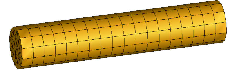

The Growth slider controls the degree of layer stretching through the part. When Automatic is enabled, the amount of acceptable growth also determines the number of layers. The growth value is a constraint which governs the maximum rate which the element layers can grow from one element to the next. The range of this slider is from 1.0 to 2, with a default of 1.3. At the minimum setting (1.0), the layers will be nearly the same size:
At the default growth (1.3), the layers will be approximately 30% larger in the part center:

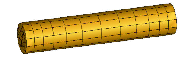

At the maximum setting (2), the layers will be quite large relative to the ends:

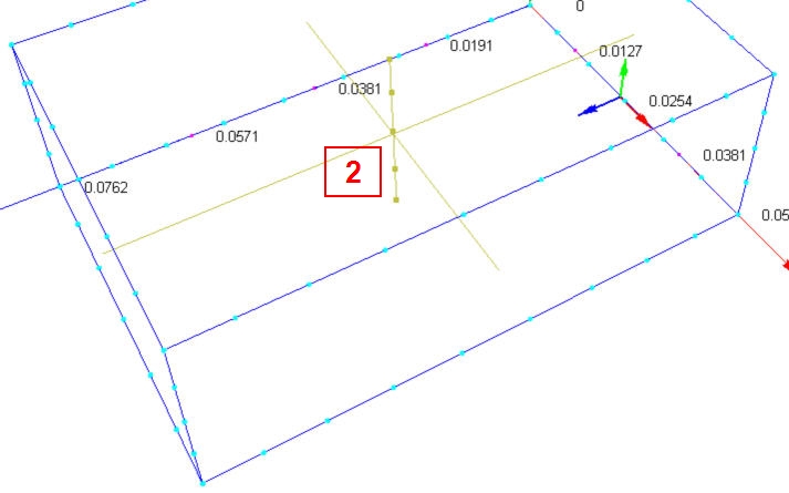

The Extrusion Direction menu lists each possible direction, and the preview line updates to correspond to the selected direction. Direction 1 is shown on the left, and Direction 2 is on the right:
