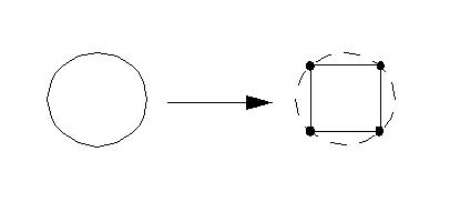

The first rule is that the geometric shapes must be adequately defined.
It is very important that the mesh sizes that you define on a model be such that none of the geometric features are mis-represented. An example is the mesh definition on a round tube. Too few elements (too large an element size) and that round tube will be approximated as a square duct:
