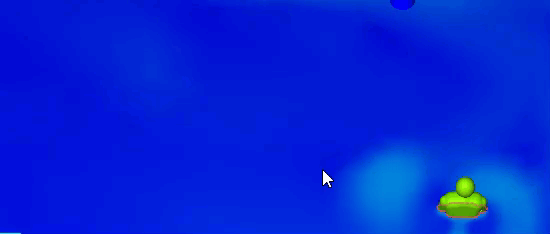

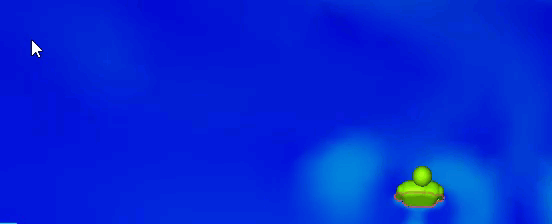

Click Add in the Regions dialog
Select the desired shape of the region from the drop-down menu (circular or rectangular).
Click a starting point for the region on a surface, plane, iso surface or iso volume.
