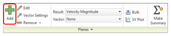

There are two ways to perform most Plane tasks:
On-model: Right click on or near the model (not on an existing Plane). Click Add plane.
Off-model: Click Add in the Planes context panel. Alternatively, right click on the Planes branch of the Design Study bar, and click Add plane:
