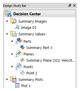

Use the Decision Center to manage all summary items:
There are three principal components of the Decision Center:

Use Summary Values for comparing results from individual and multiple scenarios.
There are three types of Summary Entities. Each answers questions such as "What is the maximum temperature?", "Which design produces the lowest pressure drop?", "Does the velocity at a point near a critical component exceed a design limit?"
