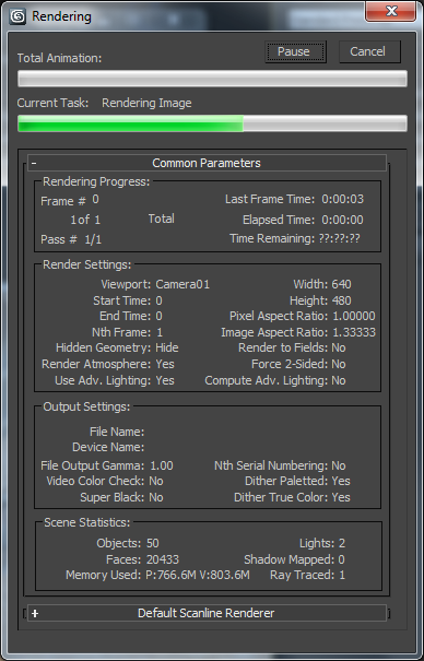

  3. Scroll down the list of entries until you find the entry for the Rendering Progress dialog:
    [RenderProgressDialogPosition]
    Dimension=-425 152 379 866
    The first two Dimension digits specify the location of the upper-left corner of the dialog, relative to (0,0), which is the upper-left corner of the screen. Therefore, in this example, the upper-left corner of the dialog is –425 pixels from the left edge of the screen and 152 pixels from the top. The second pair of digits describe the horizontal and vertical size of the dialog, so this dialog is 379 pixels wide and 866 pixels tall.
    Since this example assumes a single monitor, configured for 1280x1024 resolution, this dialog is off-screen to the left. If the first number were greater than 1280, the dialog would be off-screen to the right.
  4. Place your cursor on the “Dimension” line and scroll over to the problem number.
    The problem number is usually the first or second, since the last two set the width and height of the dialog.
  5. Change the problem number to a value that is positive and within the range 1280 to 1024.
  6. Save the 3dsmax.ini file and restart 3ds Max.
The next time you render, the Rendering Progress dialog appears appear on-screen.
This is the preferred method, because it causes no loss to other custom configuration settings that are stored in the 3dsmax.ini file.

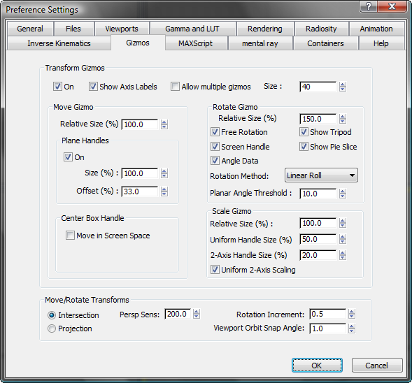

Whenever you move, rotate, or scale an object, the red axis tripod is replaced by a special-purpose transform gizmo. It's possible to lose the transform gizmo, but it's easy to get it back. If you find you've lost your transform gizmo, try these steps:
  • Open the Customize Preferences Gizmos panel, and match your settings to those shown in the following image. The most important one is Transform Gizmos On, which determines the visibility of the transform gizmo.
    Alternatively, if using the default menu system, toggle Views Show Transform Gizmo. If using the Alt menu system, toggle Scene Configure Views Show Transform Gizmo.
  • It's also possible (but unlikely) that the transform gizmo is on but is too small to see. To increase its size, press the = key repeatedly.
    The – key reduces the size.
  • You can also use Customize User Interface to add a custom control—hotkey or other—to toggle the transform gizmo. The action name is Show Transform Gizmo.
