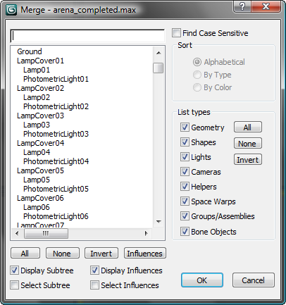

If you can access the Merge dialog, use it to view a list of the components in the scene. This helps to locate the corrupted object that is causing the load failure. Once you find the corrupted object, exclude it from the file and resave.
To use the Merge menu to locate corrupted objects:
  1. Start 3ds Max.
  2. Choose File Import Merge.
    The Merge dialog and shows every component in the scene.
  3. Select the model, click Open, and see if any of the objects or shapes in the scene are corrupt.
  4. In the List Types group on the right, turn off all options except Geometry, Shapes, and Groups/Assemblies.
  5. Click All, and then OK.
    If the objects appear in the Viewport, it means that those scene components are not corrupt.
  6. Now, do these steps again with other List Types turned on.
When the objects merge successfully, save what you've merged ao you can use it to rebuild the scene. If you are still receiving an error message, it means one of the objects is corrupted. Do the following to locate which object in the list is corrupt. .
