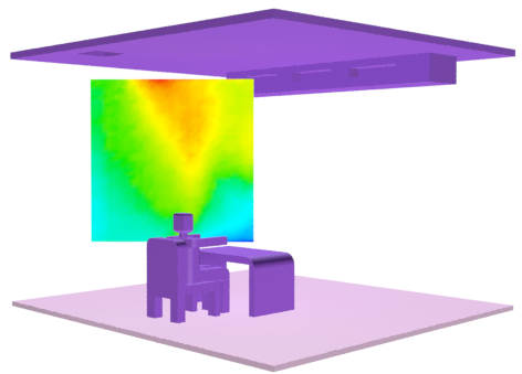

Visualizing CFD Data as Color Gradients
You can visualize data from a CFD simulation as vertex colors on geometry in the scene. For example, you use a subdivided plane to see a slice of the temperature, pressure, or speed fields as a color gradient.
