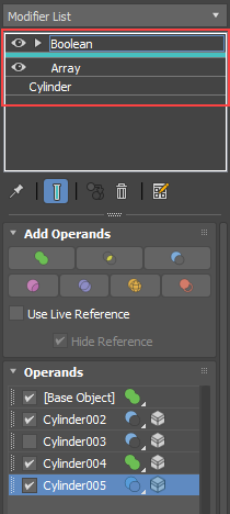

Captured Operand manipulation
Selecting a captured operand from the Boolean modifier Operands list causes it to appear in the Modifier stack. Now, a new line in the Modifier Stack separates the Boolean modifier's base object from the selected operand, visually denoting your selection. The line is grey when the captured operand or its modifiers are instanced, otherwise the line is teal.
