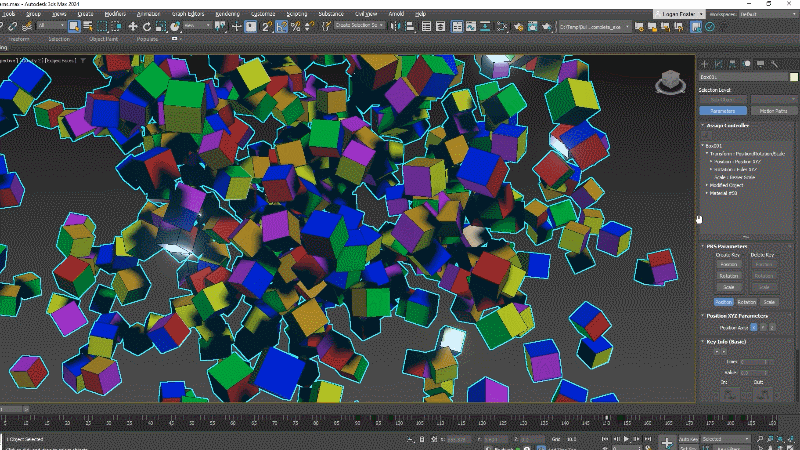

Updated List Controller UI Further to the Animation Controller and Transform List Controller improvements introduced in 3ds Max 2024 and 2024.1, even more options have been added to the List Controller table context menu to improve the animation workflow experience:
  • New Append and Assign options have been added to the Transform List, making it easier for you to add a new entry as well as adjust the controller assigned to it.
  • The List Controller Context Menu has been updated to include Copy and Paste Controller, Assign Controller, Track View, and Wire Parameter options. This context menu now appears when you right-click any List items in the Transform List rollout.
  • Additional small improvements have been made to the sub-control display, minimum dialog sizes, as well as:
    • Retain Assign Controller rollout open and closes state between sessions
    • Improvement to Motion Panel Controller Selection interface to better handle tree selections, while providing the same selection experience as the legacy system, along with enhancement of persistent scrolling and scaling
    • Addressed issues where the Pasting controllers as instances failed if the parameter block entry already had a controller
Controller Context menu enhancements A new group of Controllers options, including Open Controller Properties has been added to the right-click Context Menu found on most spinners, the Motion Command Panel Assign Controller rollout, List controller, and other areas to let you access the property dialogs settings that drive controllers such as Noise, Float List, and so on.
Also, included in this new controllers properties area is a Assign Controller option that lists available controllers. This appears instead of the Assign Controller dialog that would previously open.
Note: You can still open the Assign Controller Dialog using an option at the bottom of the controllers list.

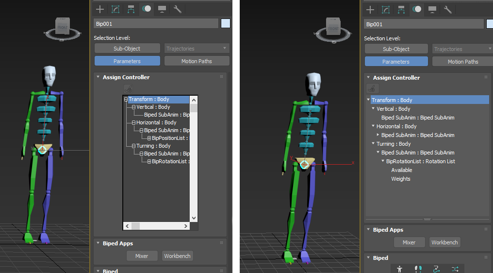

Biped Enhancements
Several changes have been made to improve the Biped experience, with errors and stability issues addressed.
  • The Biped List Controller UI has been updated (see image comparing v2023 and v2024.2.)
    Biped List Controller: Left: 2023, Right: 2024.2
  • Fixed an issue with Biped Motion mixer slowing down playback.
  • Resolved conflicts when pasting data between Xtra bones where the Paste and Paste Opposite created noise in the animation curve. Previously, this needed a workaround that required reloading the scene. Now, the animation data is properly updated when pasting a Pose to Xtra Bones, so the distortions to the animation curve no longer occurs.
  • The Biped .BIP file Save dialog defaults have been updated based on your feedback and, as of 3ds Max 2024 Update 2, the following BIP save dialog options are now off by default:
    • Save MAX Objects
    • Keyframe per frame
    • Save list controllers
  • The Biped context (right mouse) menu has been updated.
    • Expand Tracks and Collapse Tracks options are renamed Expand and Collapse
    • Select All/Invert/None have been relocated to the bottom of the menu
    • Assign Controller, Copy Controller, Paste Controller, and Reset to Default Controller are moved to the top the menu
    • Added Open Controller Properties, Show in Track View, and Show Wire in Parameter Wire Dialog to the menu
