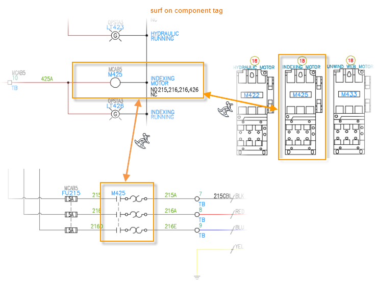

AutoCAD Electrical toolset adds cross-reference information to related schematic components indicating the reference location. The parent component is annotated with the reference location of each of its children. A child component is annotated with the reference location of its parent.

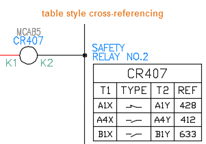

AutoCAD Electrical toolset supports three types of cross-referencing annotation on a parent component.
Cross-reference annotation on a child is always in text format.

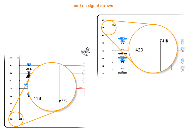

Cross-reference information is also added to signal arrows. A source arrow is annotated with the reference location of each of its destination arrows. A destination arrow is annotated with the reference location of its source.

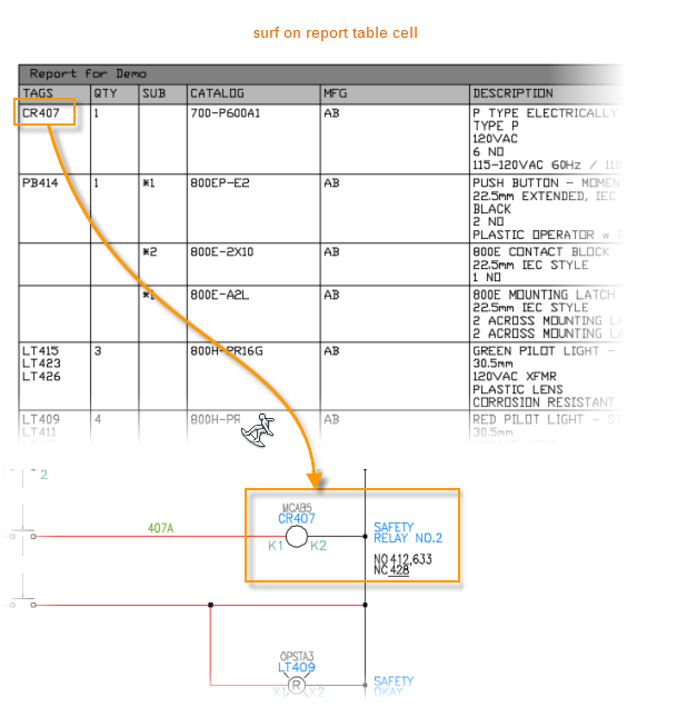

The Component Cross-Reference command creates two reports:

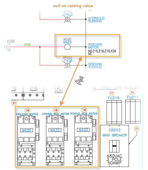

Surfing is a way to jump to related components or to follow a signal arrow. Find
