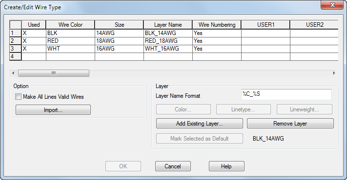

Use the Create/Edit Wire Type tool to create or edit existing wire types. Find
Existing wire layers are listed in the grid. Edit the color and size by typing in the grid. To rename a layer, right click on the layer name and click Rename Layer.
To create a wire layer, enter a wire color and size in the blank row. A default layer name is entered and can be renamed as needed. During a wire number operation, wire numbers are added to all layers unless they are defined as "No Wire Numbering". This option is useful in some cases, for example one-line drawings. Use Color, Linetype, and Lineweight to define the layer properties.
To change a layer so it is no longer a wire layer, select the row and click Remove Layer. The layer still exists in the drawing but any lines drawn on that layer are not considered wires.
Wire layers are defined on a per-drawing basis. Click Import to bring wire layers from another drawing into the active drawing. You can also define wire layers on a template drawing. That way any drawing created using that template will contain those predefined wire layers.

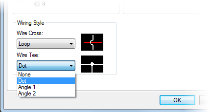

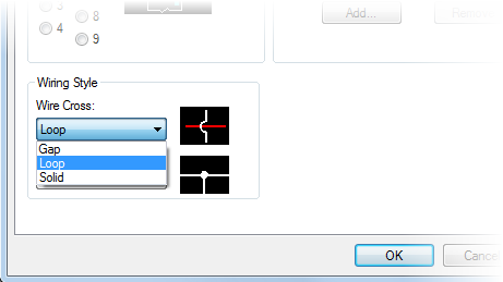

When a wire crosses another wire, it can receive a loop or a gap as defined on the Styles tab of the Drawing Properties dialog box.
When a wire ends at another wire to form a tee connection, it receives a dot or an angled tee as defined on the Styles tab of the Drawing Properties dialog box.

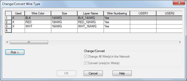

Use the Change/Convert Wire Type command to change wires to a different layer or convert lines to wires. Find

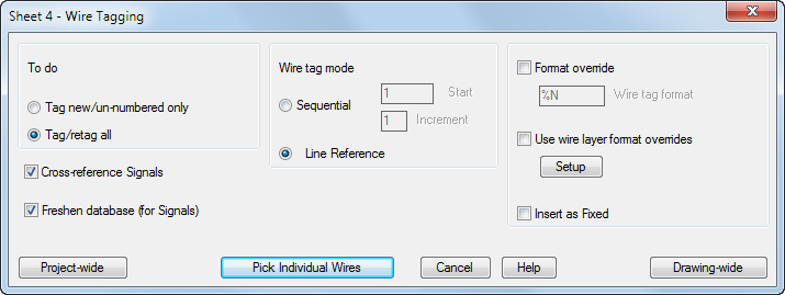

Use the Wire Numbers command to insert wire numbers or to update existing wire numbers. Find
The drawing property settings are preselected but you can override these settings. Wire numbers marked as "Fixed" do not update when you use the Wire Numbers command. Use the Edit Wire Number command to mark a wire number as "Fixed". Find
