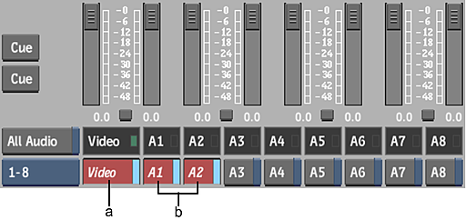

  2. Make sure that the correct video track and audio channel buttons are enabled so that the corresponding video track and audio channels are output to tape.
    (a) Video track enabled for output  (b) Audio channels 1 and 2 enabled for output
