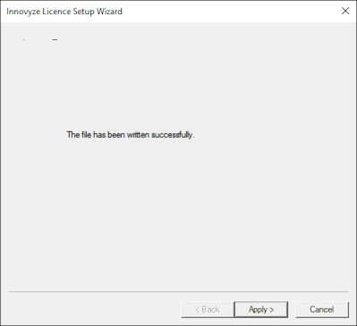

Click on the Next button. The HID file is automatically created at that point and the following dialog gets displayed:
Licence Setup Wizard - confirmation message regarding the generation of the HID file
Click on Finish to complete the process.
The generated HID file should be sent to Innovyze Support so that a licence can be generated. In return, Innovyze Support will send the user a licence file (with a LIC extension). This file can be used to apply the licence, by using the Apply licence file option of the Licence Setup Wizard. See Licence Setup Wizard - Apply Licence Page for more details.
