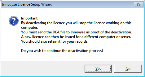

When deactivating licences, after the Next button is clicked, a warning message is displayed warning the user that the licence will no longer work (see screenshot below). Click Yes on that message to continue with the deactivation. The
Deactivate Page gets displayed.
